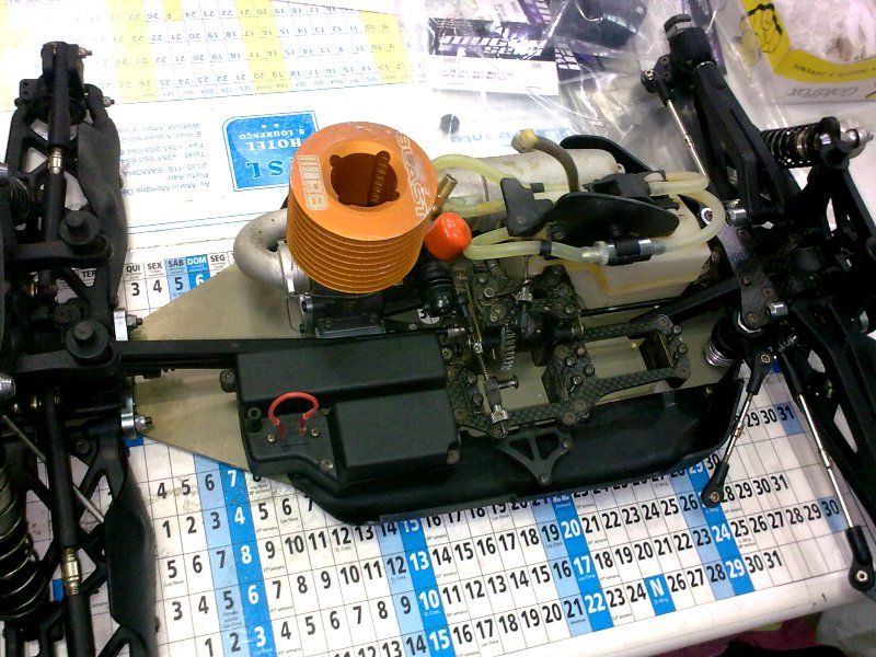

I bought a nitro chassis from a Mugen mbx6-t and it was like this:
-Removed the Nitro motor and still have, if anyone have interest
-Gathered a brushless kit specific for the Mugen Mbx6-T nitro and starting converting it.
It needed a body and a new wing & tires by the way... so:

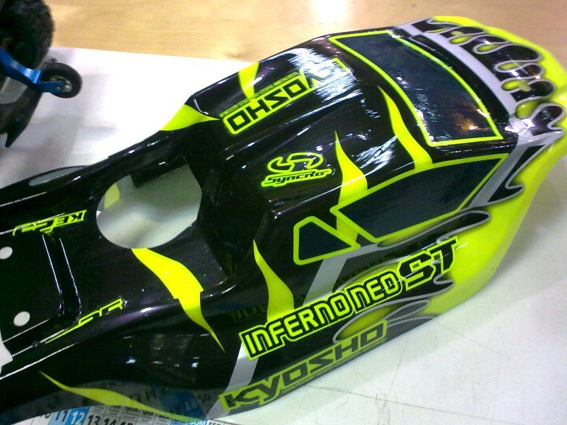

-I liked so much this body that i can't resist to try it out... it fits with some diy work, but all my stuff is modded so...

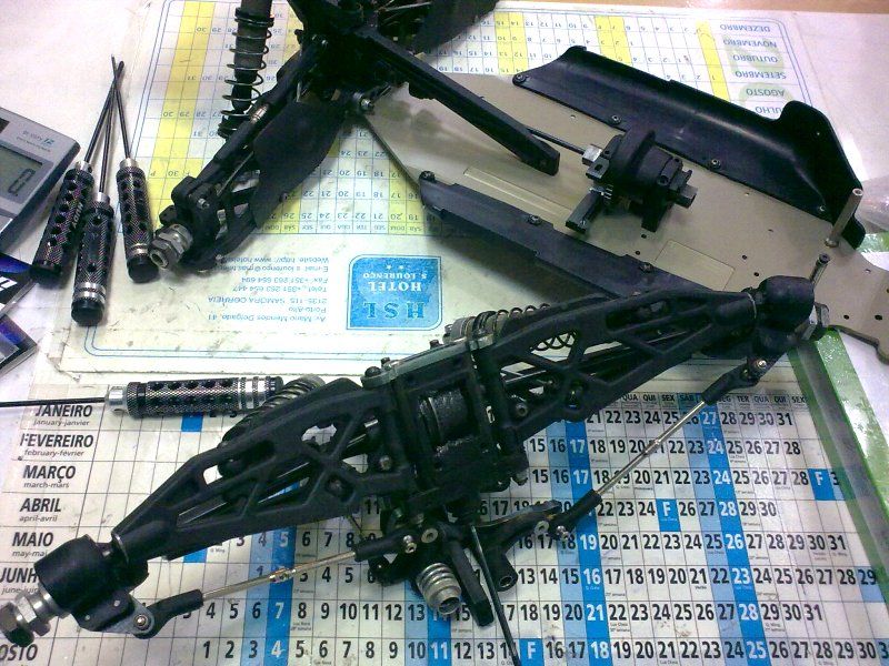

And i eared a "click" on the drivetrain. Well it is second hand.. so i know it could happen...
-Open the diffs... and find who's the guilty!
-Found... it was the front pinion gear! She a little wear out... and had a shim. I put 3 shim's on her and one more on the ring... seens good. Parts orderd already since this is gonna last just not like new!
-I open the bearings e-clip with a pin.
-I use 1:1 disc brake to clean bearings.
-Grease the bearings with teflon based grease!
-Put new silicone oil on the front diff.
Need to work now on the center one and rear one. But no click's now after the added shims!
