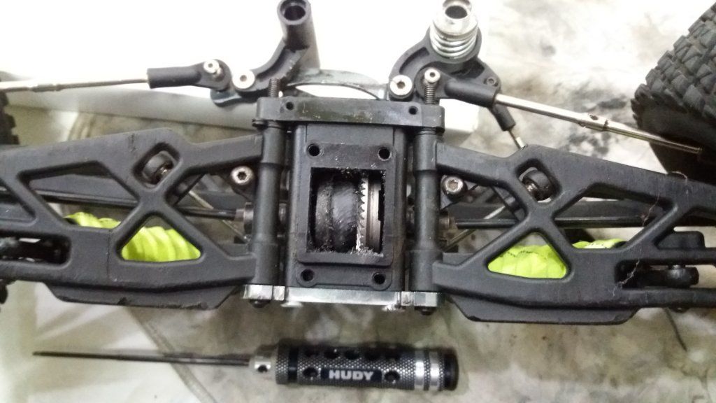

Ok, first problem out of many... I know it will have more... but i am here to solve it! lol

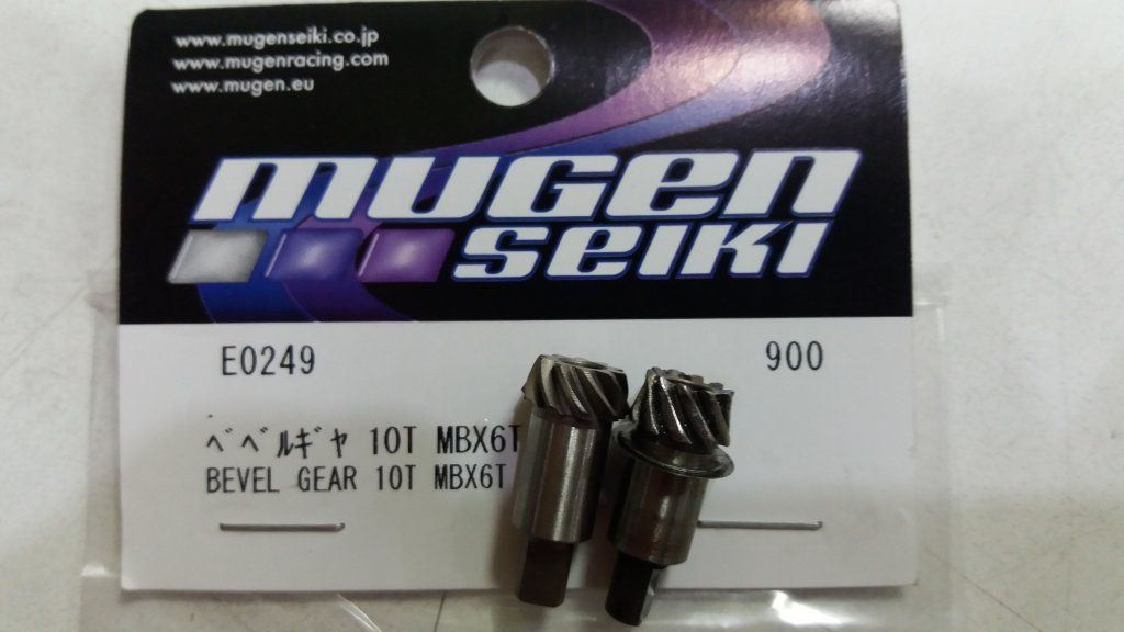

Since i bought it second hand the first times by hand i noticed a click somewhere. Investigated and it was from the front diff pinion...a coule of shims and problem solved... well ...it last 2 packs!!
So for the wait of the crown to come, i do the right things...
-New pin on the front CVD.
I have spare pinions for the crown of the diff...
-The crown seems to have still good teeth! I will use it.
-Can't say the same thing to the pinion. Remove and install the new one. Done, forget the old one.
Another pack....
Another failure...
At least i am makin the lipos "break in", lol

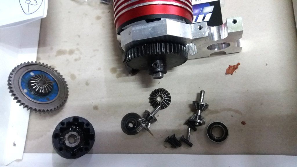

This time the center diff... is way loose... started to spin like crazy and car won't go!!
Time to remove and check!
Meanwhile, since removing, i put a new pin on the rear cvd to!
-Done! New Pins on the center CVD's.
Now the center diff...
-Oh ohoh! Black and iron flakes...
-It was the cup where the pins sit, that was all rotten, smelled like burn up plastic, and the 4 gears inside the pins are wasted....
I checked the center diff when i bought it new... put nw oil and forget the stuff as it was looking good and fine! Now on use, makes this... i wonder why... last time i checked the center CVD's they were very hot, and i tohught i have the pinion to tight to spur...but no... rather i saw the rear center CVD almost rubbing on the rear brace... so i cut a little of the rear brace to not hit the rear center CVD. Let's hope it was that....
Now a little help...what can i do to improve the new cup that is coming? I can find an alloy one but it's rare and expensive...maybe i get away fine without the bind and heating up? I saw somewhere Mr.T having metal walls for the pin's, but that require a Losi cup, right? It won't fit on Mugen?

The Losi 8ight center diff fits in a Mugen you just have to shim the center shaft to the center 2mm. You also have to shim the diff into the center case. So a Losi HD diff with metal inserts might be the route you want to go.
Ok, and how do i shim the center shaft to the center 2mm? I think i might not understand that... can explain better or with pictures?

Its simple. Put a 2mm washer between the center shafts and the gearbox on the pinions.
