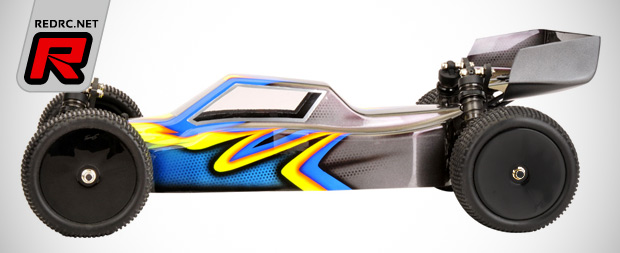

From RedRC.net: Team C Racing’s TM4 4WD buggy kit is known for some time now and while the first factory drivers got their hands on pre-production kits the actual production kits should hit the stores very soon. As reported before the buggy builds on a newly developed 7075-T& aluminium chassis with plastic side rails and it features a special layout designed around the use of 2S LiPo shorty packs. Having virtually nothing in common with the previous T4 platform the kit includes new gearboxes with updated anti-roll bar mounts, a new motor mount, updated big bore shock absorbers with upper composite caps, a newly designed slipper clutch with octagonal slipper pads, new A-arms with droop screws and updated steering parts for added agility. The kit is rounded out by 14mm aluminium wheel hex adapters and a cab forward body shell.
