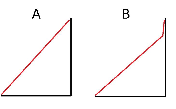

Another type of throttle "curve" that has worked well for me when I need to slow down my motor but still have good top end on the straight away is to have two straight lines in the "curve". Here's a pic
[IMG][/IMG]
I can set this on my radio, an MT4, in the curves menu. It's the ARC (adjustable rate control) option. I usually sate the point at which the lines meet to 90-98% of full throttle and the rate anywhere from 10-25% depending on the track layout, jumps, etc. Basically it makes my motor feel like a slower motor in the infield without that mushy feeling expo gives you, and I don't lose any top speed on the straight.
I also started to use this instead of expo for my steering, no mush
[IMG][/IMG]
Ok you techy guys can say all you want on paper but seriously if you back your throttle down to 80% and you imagine it that way then thats what it is. When you start micro managing and seeing into everthing you do its gonna play with your head when you race. So 80% throttle should not give you a full throttle light on the esc therefore your not getting full power to the motor and your car should be easier to control done....! Who cares about mushy or any kind of feeling. Set it so it doesnt feel that way. There has got to be a point to where it feels good to you. This is not rocket science.
Bubonic-X is offline   Reply With Quote
[IMG][/IMG]
I like that. I've been playing around with using minimal timing advance at the motor or in the ESC but then adding turbo that kicks in after I'm at WOT for more than half a second. I'm gonna try out your "curve" and see how it feels next time I get to practice.

Originally Posted by iScream View Post
The curve picture you posted shows exactly what I stated. At the beginning of your trigger pull, moving the trigger X percent changes the speed of the motor by a small amount. But you don't get that for free. If the first 50 percent of your physical trigger movement only controls the first 30 percent of the throttle signal to your motor, the remaining 50 percent of your physical trigger pull has to control the other 70 percent of the throttle signal. So you are gaining lower speed throttle control/resolution by sacrificing higher speed throttle control/resolution.
Emmmmm .... The first part of the curve has a mild reaction time. Then when in the later part of the curve it become closer to the liner curve which is faster and more responsive. Not really seeing how you're sacrificing higher speed throttle control. anyways..
You are not using minimum throttle the way Tekin intends. Not that there is anything wrong with that if it works for you. What they tell you to do is increase minimum throttle one notch at a time until barely moving your trigger makes your car barely start to move. Then you are done setting it.
There is a bit more to Throttle min than that...I play with throttle min's all the time. Depends on the track.
