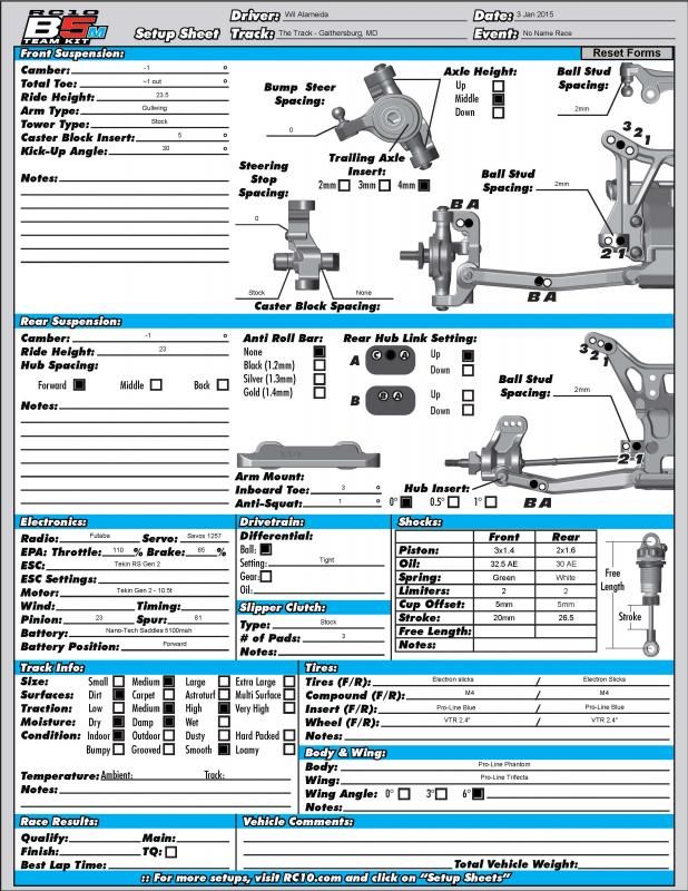

This last weekend, I switched pistons up front, going from 2x1.7 to 3x1.4 flat, and didnt notice a whole lot of difference... Im running on a clay mix track that is super smooth with only two jumps, and am finally coming around to quicker times.. However, Im just not getting that "edge" while driving through the infield. I think this may have some to do with the camber gain and link positions. I am looking for the simple fixes that I can do with keeping as close to box stock as possible.. Or even just using option tuning parts that are included with the box setup.
Thanks
Also, attached is my current setup.

Which rear arms are you using?
Thanks
If you want more responsive steering in the infield of a track, reduce the amount of washers under the front camber link ball stud. Going down to 1mm.
