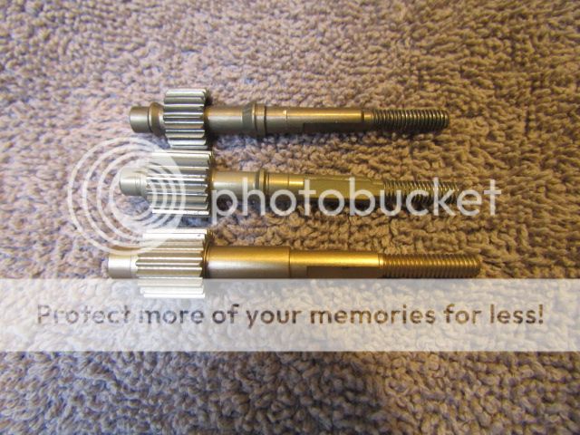

I just got a lot of B5m parts and there is an Exotek aluminum top shaft. I see that is a larger diameter than the FL and MIP top shafts. I have bearings that will fit, but my question is how does it stay centered in the gear box? It seems like it needs a spacer between the gear and bearing. The FL and MIP have a stop built in. Photo: Top MIP, Factory Lite, and then Exotek.

Looks like you are missing the sleeve that slides on the shaft to space it correctly.
I have one on my bench, I can take a picture of it, later tonight, if needed.

asc 91426 top shaft spacer.
