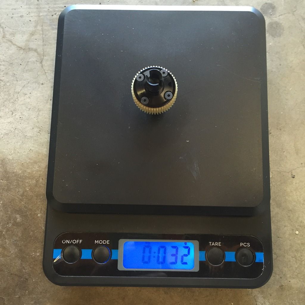

B6 gear diff drops right into my B5M lite (using no shims). I bought a B6 and put the B5M ball diff in there and the B6 gear diff in my B5M.

B5M ball diff:
B6 gear diff:

sweet.... let us know how the B5M drives with the B6 diff gear.
