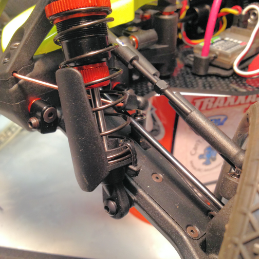

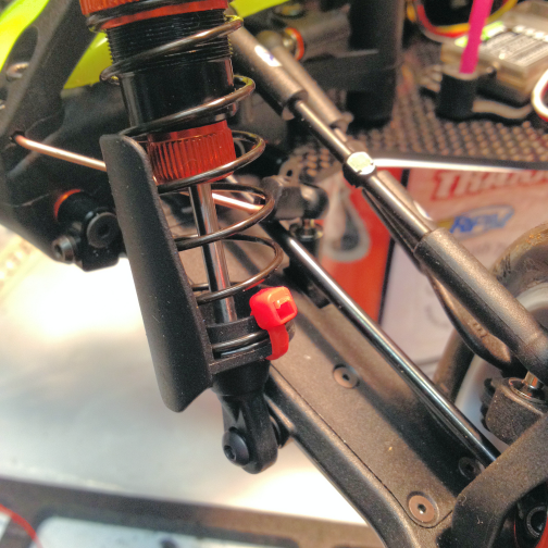

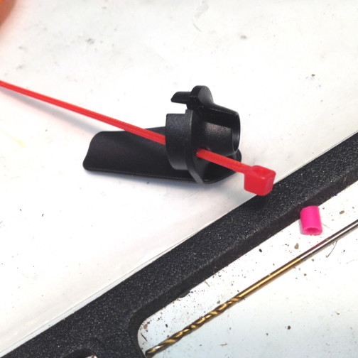

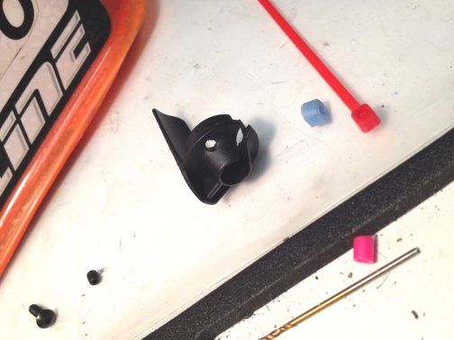

I really like the spring retainers with the built in mud guards. But Some have reported they pop off, so I decided to go to a method I used when I had issues with spring retainers coming off. I drilled a small hole in the retainer and use a tie wrap to secure it to the spring. Hopefully this will stabilize the retainer enough to keep it from dislodging from the shock.
I drilled a small hole in the spring retainer.
Then I threaded a small tie wrap thru the hole.
And then secured it around the spring. I used a red tie wrap so you could see it better.
Here I am using a black tie wrap and you can barely see it.
AE B5M - Tekno SCT410 - Kyosho SC6, SCR & RB6 - HB D413
SCVRC - Santa Clarita Valley RC & HotRod Hobbies
Shark413 is offline   Reply With Quote
