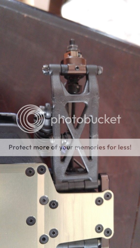

Default my mod
This is my mod to fit the gulf arm
Kyosho Lazer ZX-6 & ZX-6.6 4WD Thread-img_20160410_110400.jpg   Kyosho Lazer ZX-6 & ZX-6.6 4WD Thread-img_20160410_110446.jpg   Kyosho Lazer ZX-6 & ZX-6.6 4WD Thread-img_20160410_110515.jpg
