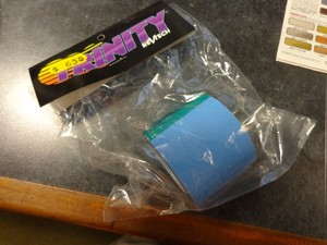

Originally Posted by EricW View Post
Use Trinity servo tape, make sure you clean both surfaces with motor cleaner before applying the tape. Never had anything come off using this tape. The Parma clear tape is sub par IMO.
is that silcone or foam? The foam crap is such a pain to clean off
Its the foam stuff and it's hard to get off because it works.
Pro Tip: When removing it simply spray a bit of motor spray on the foam and it will come right off.
