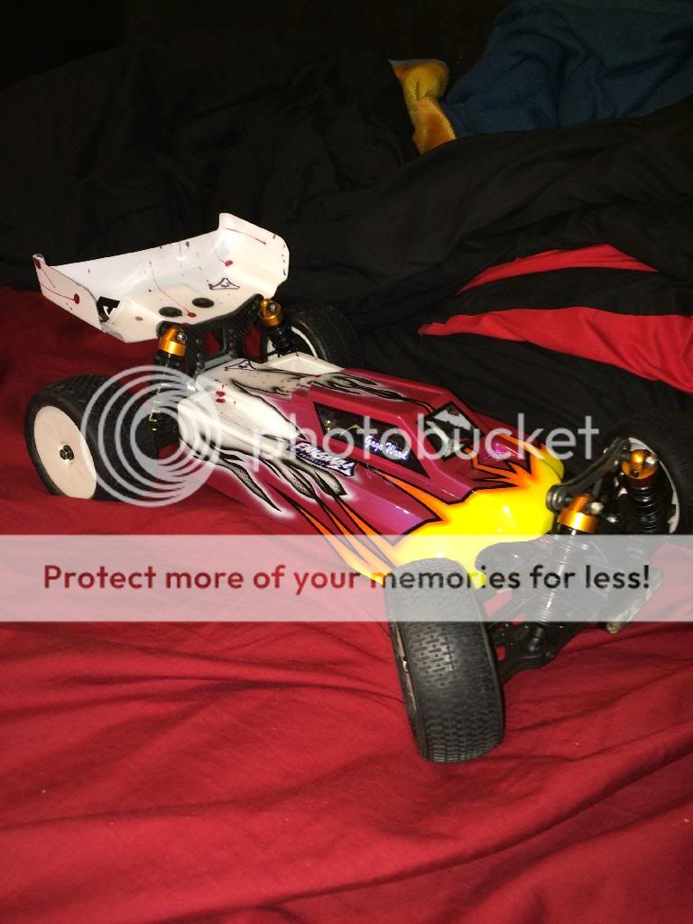

My 14 when I gets stickers in it will look better but no to bad. I love this car they handle amazing the v2 and 14 both.
Good lookin buggy!
