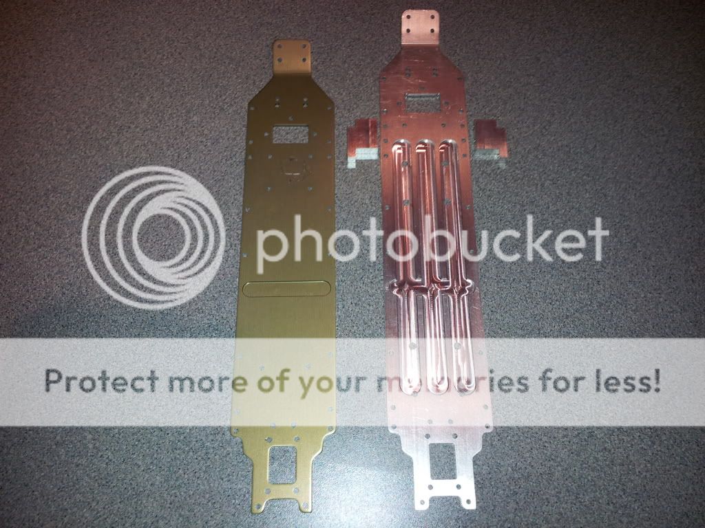

Anyone looking for an aluminum chassis, decided to sell my brand new custom machined chassis. Had planned on running truck when I had it made, but the class is not as deep as I had hoped it would get.
Brand new aluminum DEST210 chassis
Looks awesome. If I wasn't happy with my type B, I'd buy it.
