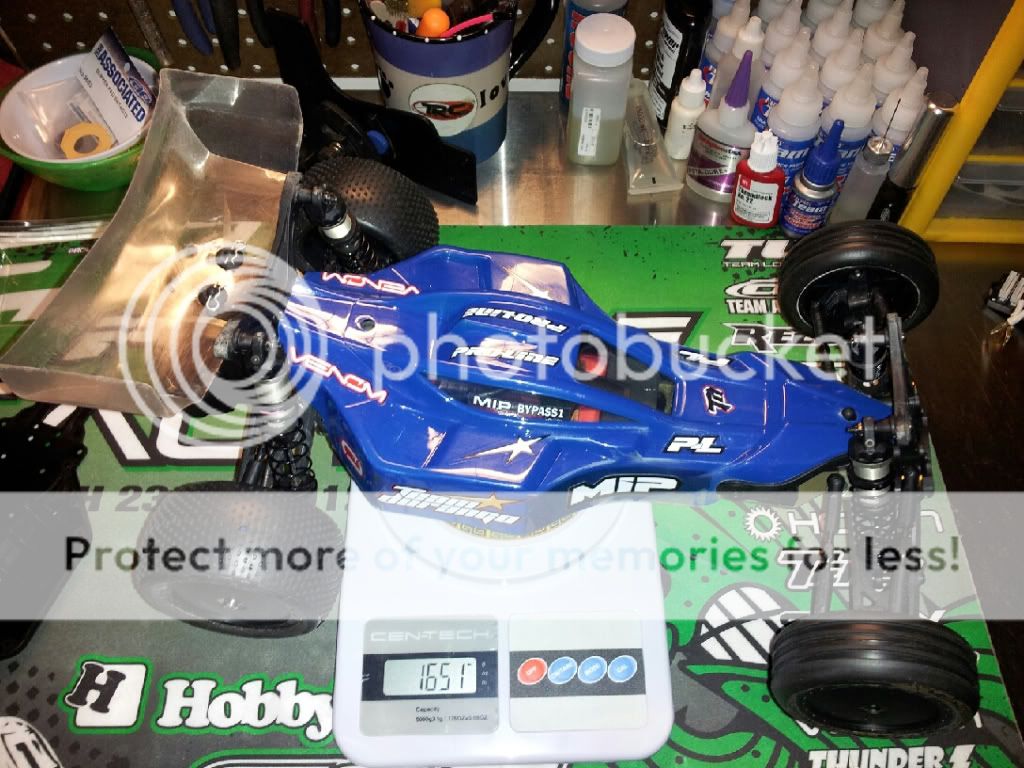

I just switched to running stock, and now I need to do something about weight. Right now I am still in basic kit form aside from aluminum rear hubs. So this is basically stage 1 of my diet and as I cut weight I will post progress.
I have the +8 Dimec and the painter is finishing up soon. Also have a Futaba BLS551 servo (44gr) coming. I also plan to get the milled motor plate, vented slipper plates, and titanium turnbuckles/ballstuds. I would like to be around 1550grams or under. Adding is easier than subtracting.
