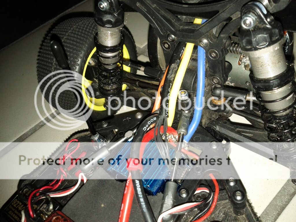

Turnbuckles instead of the rear brace.

Nice, dont like the way that top piece mounts, kinda a pain to get at the sway bar set screws. I just removed the screws that come up frome the bottom, and used set screws as locating pins, should be good, plus now I can remove just that top brace to access the sway bar.
built up a 1.3mm bar for it today,
May try your idea too.

Heres a clearer pic. Where did u get the sway bar?

Sway bar is from my parts bin, originally for a TOP Photon tc. If the HD ball cups give me problems, I will use TOP cups and balls as well, as you can see on the pic, the TOP cups are massive and never gave me any problems.

Personally, I would mount the ball studs on the top of the trans, not under as you have done, the greater angle would give more rigidity. Which is the point of the links( or top plate). As you have it, it probably is not giving much, if any.

I tested both ways. Seemed more solid this way. No awkward forces on the ball cups. Perfectly parallel to chassis. I could mount it on top with the schumacher cougar front bendy bits so its parallel to chassis but like this way better. Pushing the gearbox in forward is super rigid both ways. Pulling it backward is where the brace helped and this arrangement works. Plus those titaniums are way stronger than the plastic brace.

Thats cool, whatever works for you Just saying, that from an engineering point of view, something that is triangulated will be more ridged than something that is boxed. The Ti may be strong, but the assembly is only as strong as the weakest part, in this case, the ball cups. The plastic OEM part, with much more surface area under a clamping load from the multiple fasteners, will be stronger in compression and tension, and much stronger in torsional loading. The ball cup link design will have no torsional strength at all due to the balls. That being said, the increased flex (torsional) should be a good thing on low traction surfaces.
