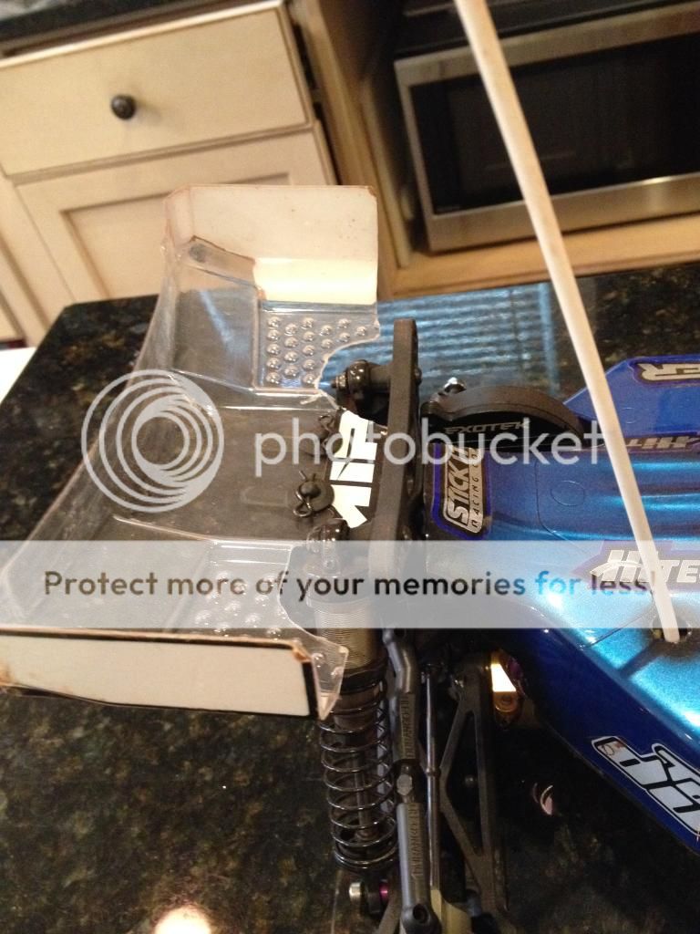

Originally Posted by tc5 man View Post
How did you mount the Rear shocks behind the tower without the wing getting in the way ?
Had to cut the wing up to make it work No biggy.
tobamiester is offline   Reply With Quote
Got any pics of where you cut on the wing ?

@tc5 man: have a look at Jorns car, here you can see the cut outs on the wing for the shocks.
http://www.neobuggy.net/2013/09/24/t...-v2-spy-shots/
@Marco926: the outdrives from the gear diff should be long enouth, the older outdrives fron the ball diffs on the v1 were be a bit to short, whene you used full droop on the rear!
Ok it looks like he cut in front of the wing.
Or mounted the wing back il need a new one to mount it back though.

If you guys want to run the shocks behind the arms, the shock angle is wrong. The shocks should be perpendicular to the arms. In the current layout the shocks lean forwards. They bind slightly and you'll wear shock shafts and seals faster. The solution is easy. Take a V1 rear tower and cut the two legs with the mounting holes off and use them to space the tower back. You'll need longer screws and still have to do something different for the wing mount braces. If you don't have the tower spaced back, keep your shocks in front.
Here's a pic from Team Durango's website
Leo Lorenzen

I wouldn't worry about angle to be honest. It's worth trying at the expense of making a few cuts in your wing. Here is my shock angle. I added spaces to move the shock away from the camber link, which makes the angle a little more extreme, but there is no binding.

A shock should always be perpendicular to the suspension arm. Durango designers are creative but they have a fundamental lack of understanding of basic suspension design.
Thanks for the pic . you went back to 4 gear mid motor it looks like ?
